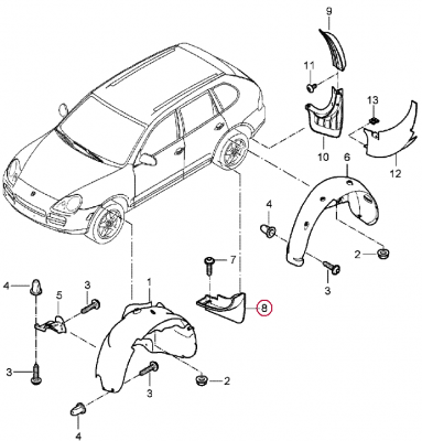

Hope you can help need the part number for the front mud flaps - hope there is a separate code for each side as I have got three from fleabay and just need the remaining one.
Can only find references for the rear ones on the PET system :(
Do you know if there is a TSB or anything regarding the fitting? Hope it's just a case of remove wheel & screw on, but best to check

955.505.547.00 Left front mud flap (spoiler) -- US MSRP $16.68
955.505.546.00 Right front mud flap (spoiler) -- US MSRP $16.68
Looks like it is just one scew that holds it in.

That is as far as I got - local OPC not much use
If you look again that part is in front of the rear wheel and is a spoiler. OPC was going to order this as the front mud flap but says this bit keeps some of the road grime from the rear suspension.
Especially useful if you have air suspension (I don't know why).
They don't think the part is availble - even though I have one already lol
