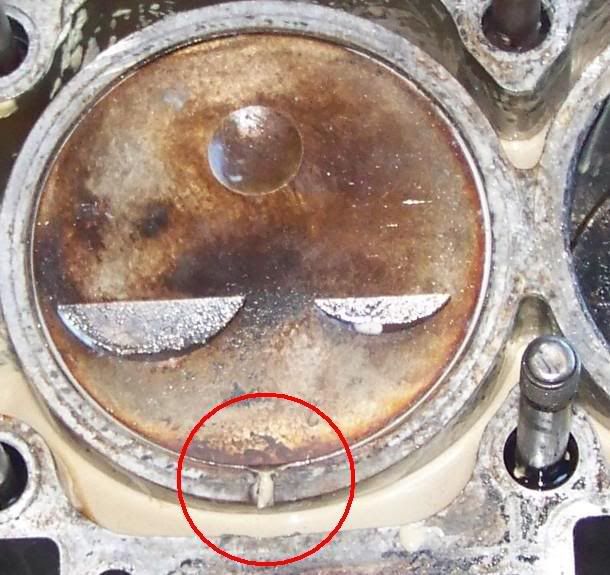

I have a 1989 2.7L 944 bone stock that has a curious disorder. There is a "burn-through" in the top of the #4 cylinder wall. Got the car this way. However, I am seeking a new block for the car and am I correct in assuming any 2.7 or 3.0 944, 944S2, 968 block should work?

After discussion with Ian at 944 Online, he suggested that it's a hot spot caused by a bad injector. Given the location of the hole, that seems to make sense. I've never encountered this phenomenon and although I didn't do it, I know I should take steps to avoid it.
New block is on the way and I will be busy for awhile accumulating the necessary rebuild parts: Rings, bearings, etc in order to properly do a rebuild so I don't have to go in and do it again in a few month's time.
