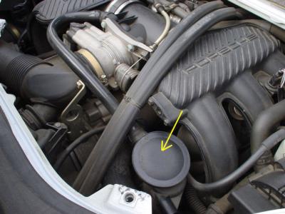

This is the horizontal one like on my 1997.
