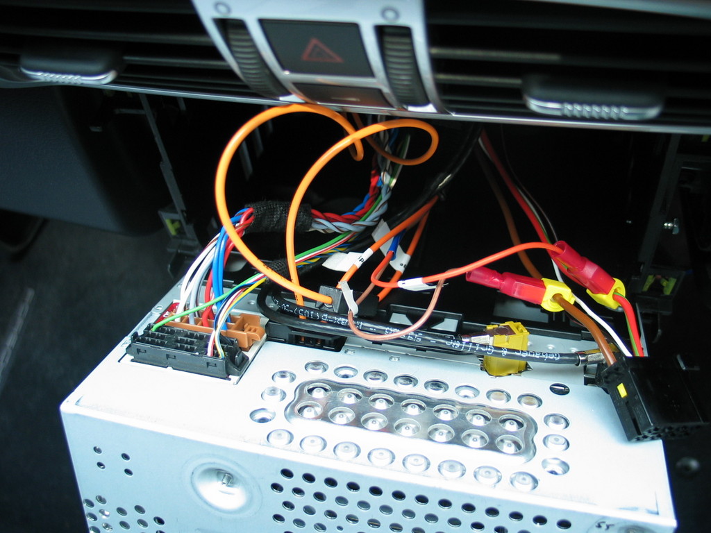

After pulling out PCM, swap fiber optic strands CAREFULLY as per MoBridge instructions for Tyco connectors and tap into power and ground using 12 gauge taps and 22 gauge blade connectors from Radio Shack. Here is a picture showing the taps and orange fiber optic cables.

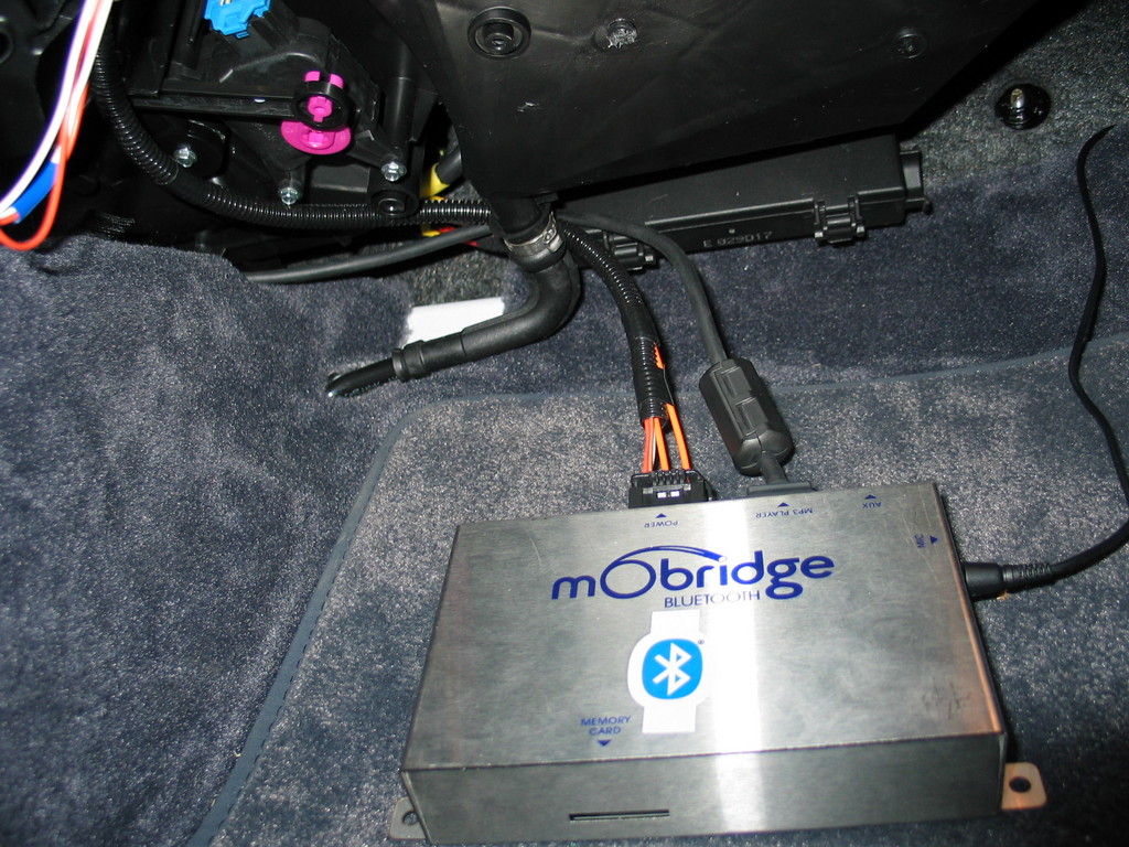

A sweet place to mount the unit with extremely easy access for SD card firmware upgrades is behind the glovebox, in a slot with just the right width, under a foam trim piece. I used industrial strength Velcro form Ace hardware to mount the light unit behind the glovebox,
The following photos show the mounting of the unit in the slot between firewall and back of glovebox:
Ready for insertion, with all wires and cables routed, I added a cable sheath as well:
View looking up from floor on passenger side- unit mounted in slot between electrical control box and plenum chamber, just behind glovebox, and held fast with extra strength Velcro - no bump will dislodge this from the velcro !:

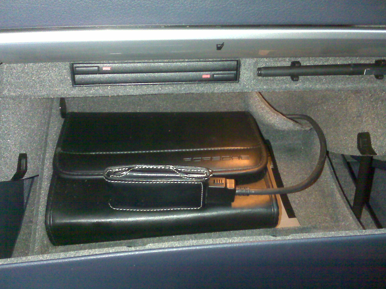

Finally, snake the cable up from underneath into the glovebox:

I didn't have the courage to do the install - just daunted by the optical cable work. Probably could have done it. The one tip I'll offer is that the tech who installed it (who had installed quite a few apparently) chose to place the unit on the drivers side, virtually directly under the steering wheel shaft. It has the mini-sd slot directly accessible if you peer under the dash there. Turned out to be useful in that I had to re-install the firmware when, after replacing my battery, the unit stopped working. Booting it from an sd card with a firmware upgrade from the MoBridge site fixed it all.
