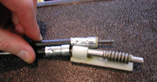

Here is a pretty crummy picture showing the length of the old vs. new cable. The ends on the other side (the side you can't see) are equal, so as you can see, the new cable is somewhat longer than the old.

Also removed the cable from his new style transmission. There is a 1 inch difference in the length of the cable housings. :angry: Cannot just swap the cable housings like we use to do, so we did not have to play around with the worm gear.
