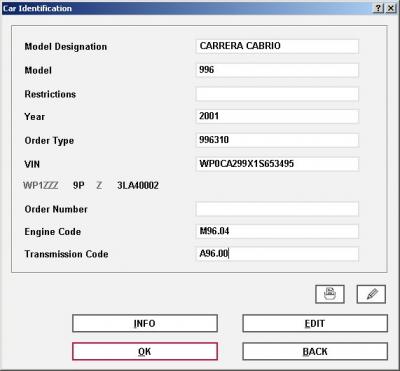

this is the vin no. btw
WPOCA299X1S653495
Here we go..
The VIN is telling us it has a A96 (ChickTronic)
Sorry.. forgot to tell you: A96.30 would be ChickTronic all wheel drive along with package: M339
This one is two wheel drive :)
B
Thought I'd go ahead and run the sheet for you :)
C2.pdf
B
