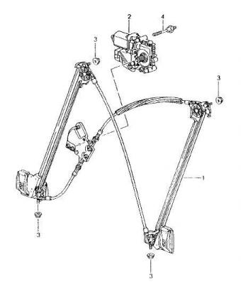

Power window mechanism is only available as unit WITHOUT the motor, the squeak is caused by the mechanism which gave hot the best part of his live.

Chris:
As RFM says, the cable itself is not available as a separate part. You can only buy the entire window regulator mechanism as a unit. Once you have your new window regulator, you just remove the electric motor from the old unit and then install the electric motor onto the new window regulator.
One shortcut to avoid having to measure the distances from the front edge of the window glass etc., is to NOT wipe clean the bottom edge of the window and use the "dirt marks" to locate the glass onto the two window clamping jaws.
One other note. If you haven't yet removed your old regulator assembly, be sure to mark the location of the base of each of the two window regulator legs on the inside surface of the bottom (horizontal) face of the door. You can then use those marks when you install the new regulator legs (10mm bolts) without having to be concerned with the inboard/outboard angle of the window glass.
Also, to avoid having to immediately have to open up the door panel again, make sure you follow the caution about where the "block" insert is located at the base of the forward leg of the regulator. There are two possibilities with respect to how your regulator came pre-set, one for Boxster height, and the other for 996 height.

Chris:
One more thing I forgot to mention.
The window regulator is the same part for 986 and 996, but you have to make sure that the "bump stop" at the base of the front leg of the regulator is set at the right position for your particular model. If you don't the window will not go down to clear the top of the door on a 986.
I think "Tool Pants" has some photos in one of his posts showing what the bump stop looks like and what position it should be in.
Also, in the diagram that Chris posted, you can see the two nuts at the tops of the legs (both labeled #3) that I was referring to regarding not operating the electrical switch to line up with the holes in the door skin that allow you to tighten them.
Regards, Maurice.
