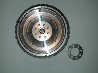

My question is why does a light flywheel "rattle" at idle? What exactly is happening internally to create that sound?

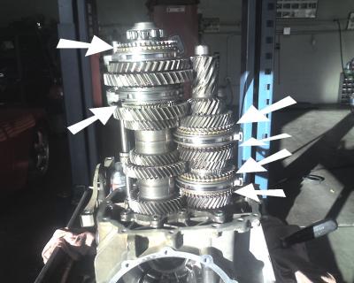

This is a 6speed 996 tranny. The synchro's are multi part and RATTLE when not dampened. Porsche goes to great length to make sure the cars are "dumbed" down. If I handed you a gear with synchro (covered in gearlube) you could shake it and hear the same "rattle" he is hearing from his car at idle. The gear lube we run today is nothing like what we ran in the 901's/915's/930 boxes. It is much thinner and synthetic. All this factors into the rattle he is hearing :)
Every arrow in this picture points to a synchro. Every synchro is a rattle.
B

The noise has always been there. Promise. You just don't hear it with the dual mass flywheel. The dual mass is a harmonic balancer of sorts, but primarily for the INPUT shaft of the tranny not so much the crank. The 997's have a harmonic balancer at the front of the crank and the dual mass flywheel.

Your fine. Sorry about the confusion. Push the clutch in and it the rattle does go away. The TO has a different sound.
I re-read my post and it confused me.. LOL:
When the clutch it out, the input shaft is turning the same speed as the engine, push in the clutch and it slows down and gets quieter.

I will admit different gear lubes will increase or decrease the noise. Mobil1 = rattle with light flywheel.
As far as vibration: the Aasco flywheels are *pretty* well balanced out of the box, but not perfect~! The stock flywheel.. is WAY off, but the rubber dual mass dampens the effect.
