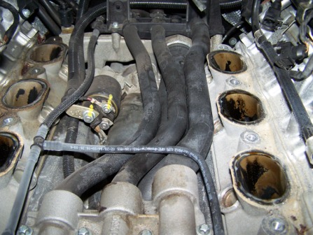

Only the intake manifold gasket is needed ( V8/V8T) after starter replacement. If the water tubes above and besides the starter motor are still in plastic, it's recommended to change them with the light alloy updated version due cracked tubes and water leaks.
I am in the middle of the coolant tube job. Here is a photo with the tubes over the starter and one with the tubes removed. I am also servicing my starter while everything is apart. RFM is correct about the intake gaskets 2 at about $30.00 total.
