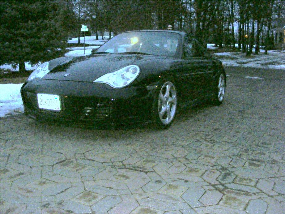

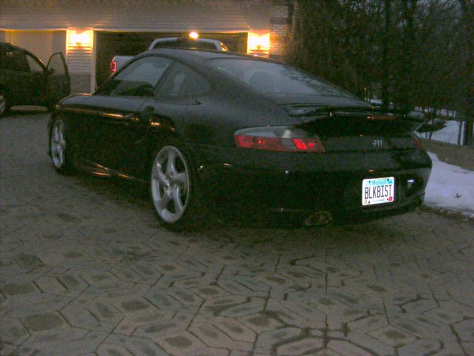

i currently run h/r with bilsteins hd and h/r sways ...to me perfect street setup not the best pic with cell
