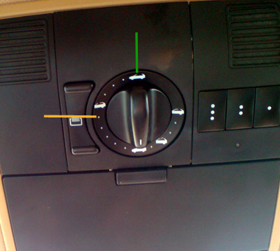

I found a solution
Will the 1st window still slow, but never hang
Because when we open it full both windows 1st one and the 2nd one moving together, and that’s why the 1st always hang.
So start opening the first one only as you can see in the picture move it to the orange line you gonna wait for maximum 30sec, then continuo to the green line they will both open without any problems
and When your going to close it do the same half a way to the orange until 2nd one closed then continuo to the bottom to make the 1st one also close with no hangs
Working %100 with me
