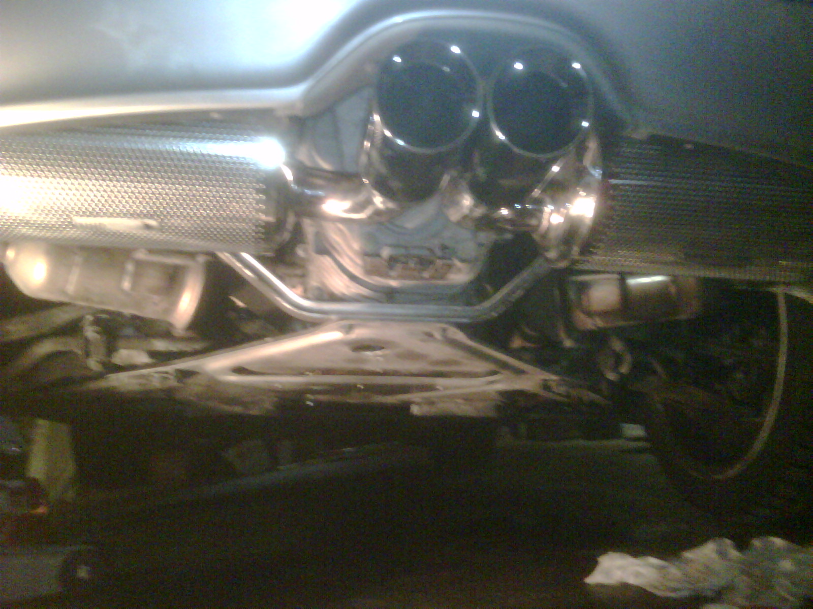

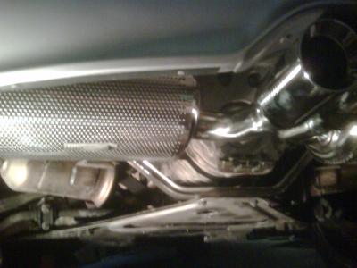

Installing the new NHP muffler is very easy and quick. The muffler still uses the stock u-pipes and cat clamp, but does come with its own muffler clamp. You also have much more room to install the 2 transmission mount bolts since the muffler is 15 pounds of less mass than the gigantic stock muffler. I personally would have like to have new u-pipes and cat clamp, but I'm nitpicking about that and probably wouldn't want to pay extra for it. :rolleyes:

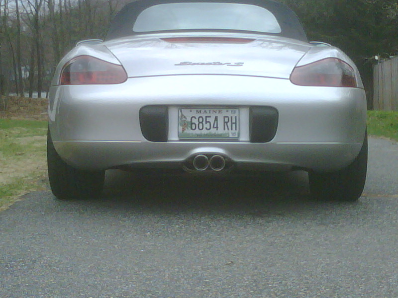

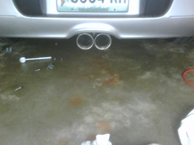

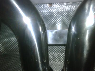

This muffler is GORGEOUS! In my opinion this is the prettiest muffler I have ever seen on a car. The stainless is very shiny but it doesn't have that cheap chrome look to it. The bottom mesh grill is part of the muffler, and although I doubt it serves any purpose other than aesthetics, is really slick looking. Of course you can only see the grill when the car's in the air, but still it's the little touches that make me happy. The welds also look very clean and the overall fit and finish of the muffler is top notch. The twin tip HUGS the rear bumper in a very nice way. I also want to point out since it's hard to tell in the pics that the tips are solid thick-walled tips and are not small-pipes-inside-fake-tips. Hopefully you know what I mean. And no melting the bumper (which was my initial concern) is not a problem with them being this close. It does not get hot enough apparently. (500 miles and still looks beautiful)
