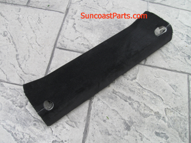

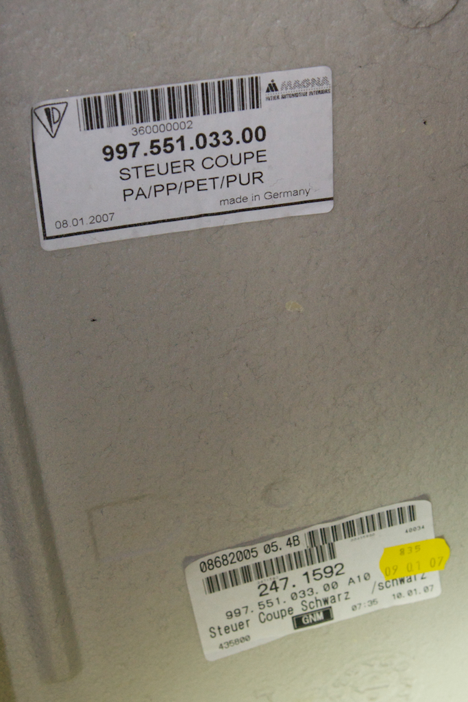

I was helping a friend on the weekend install a Porsche GT3 RS Euro/ROW clubsport roll bar in his US spec 2007 GT3 RS (#2373). As it is an early production RS it has roll bar stud plates factory welded to the floor behind the seats where the front base of the roll bar attaches, bosses welded to the floor under the seats to screw in eye hooks for the sub belt attachment and even stud plates welded to the floor in each of the foot wells to bolt a front roll bar extension. Installation of the Euro/ROW clubsport roll bar was straight forward however we spent considerable time measuring and cutting the rear shelf carpeting and undercushioning for the bar pass through where it bolts to the rear shock towers (see attached picture). The carpet undercushioning is difficult to cut with any precision as it consists of thick, spongy foam (up to 3" thick) and some rigid styrofoam. It occured to me that a better solution would be to order a replacement carpeted shelf piece for a ROW spec 997 GT3 RS that came with the factory Clubsport option as it should have the proper bar pass through holes already pre-cut in the carpet and foam backing? Attached is a picture of the reverse side of the carpeted panel from #2373 which shows a 997.551.033.00 part number. Do any of our RennTech forum subscribers have a ROW spec RS that came factory equipped with the clubsport option? I would appreciate the part number of the carpeted shelf panel (and pictures of the carpet cutout section)? Many thanks :)

The replacement carpet for the I003 option (Racing Safety Devices) is 997.551.033.90.A10 (It only comes in black) - $291.50
Nick, thanks for the lead :) , I've placed a call to the dealer with this information and I'll see what happens. How did you come across this part #?
I have a copy of the PET which is the same electronic parts catalog that the dealers use.
Thanks again Nick, I ordered the part and the dealer should have it before the end of the week.

Nick, turns out you had the right part number, many thanks! Here's a photo of the carpet shelf (with pre-cut holes for the Clubsport roll bar - 997.551.033.90.A10) I ordered from Suncoast Porsche. If anyone is planning a GT3 RS Clubsport roll bar installation I highly recommend you buy this part. I will save a lot of time and frustration.
Awesome result, glad it worked out for you.
