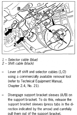

I finally decided to do the clutch and flywheel replacement myself. The whole process of removing the transmission is at halt now because i can't figure out how to get the shift selector cables off the transmission casing.
I can't figure out how to loosen the ball joint. I twisted up the three prongs on the ball joint and it should snap off, but it's not coming off.
Has anybody had any experience with this before?
