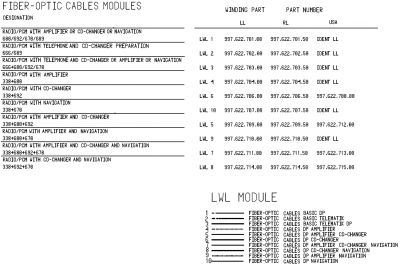

Very useful thread, I was hoping somebody could help/confirm the optical wire I need for the following application:
I have a 2005 C2S cab (997) with PCM, the PCM does have navi/phone buttons but I do not think either are hooked up ( I do not have a nav unit in the loggage compartment ).
I purchased the CDC4 changer/mount etc but the wire I have does not work since I have the amp/booster.
The instruction manual I have reads 997.622.712.00 Optical waveguide LWL, without nav unit, is this what I need? if so it is not listed above. I basically need a 1 to 2 optical wire if that makes sense since I need it to hook up to both the booster and the changer.
I found a post on this forum for the 996 but are not sure if it will be the same as 997 or not since the installation tech manual does not include some of those part numbers listed there
Thanks for your help in advance
Sam

997-1 C2 only
Thank you Loren,
So it seems that I need 997.622.712.00 can you please confirm to make sure I ordered the correct wiring.
Thanks again for the quick, prompt and helpful reply!
Sam
