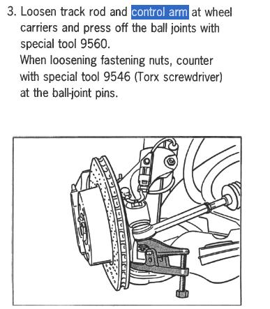

Hi, i'm trying to change the oem front control arms of my car with the adjustable front GT3 control arms but i can't separate the carrier from the lower control arm ball joint !
I don't know how to do it ... i don't want to use the hammer but i'm seriously thinking of it !!!
Please help me ... any suggestions appreciated ... special tools to be used ... anything !!!

You seem so desperate, and yet it is really easy.... I just did mine a few weeks ago (both front and rear).
This is what you need: http://www.harborfreight.com/cpi/ctaf/disp...temnumber=99849
It's under 20 bucks at harbor freight.
The pic attached indicates how to use it. Be aware of the big bang!
Joost
Edited by jperquin
+1 on the harbor freight tool
I have tried two different ball joint seperators, one from NAPA and this one from HF. I did have to file a little bit on mine to make the jaw slightly larger, but the end of the pivoting piece that rests on the top of the threaded rod is longer on the HF tool than the other I used. This is important - it has to sit fully and the top of the rod - if only half of it "addresses" the top of the rod, you can crush the threads.
Also be sure you get the thing all the way on - push the boot down to be sure you are getting the jaw up against the conical part of the control arm. It will pop almost like a small caliber gunshot when it pops off - can frighten you if you are not prepared for it!

Hi JP, i have found a very easy solution with a guy of a Porsche dealer !
I have asked him to give me for just a day the special tool to do that job, but he told me that he couldn't do this ... but he had a great solution that needed just a hammer ... he also told me that this is a solution that they don't like to use but just because they have the right tool.
Well, in few words ... one strong shot with a hammer on the rear side of the ball joint ... and it works !!! :D

Those who use a steel hammer to tap on a light alloy carrier (or othe part), are not mechanics but demolition contractors, i may hope that nobody will follow this example.
I agree 100% with you but i have found myself in a very urgent situation without the possibility to get the right tool and the need to have my car ready for a track challenge ... but, even if i don't like to use the hammer (never) i make you sure that has been a very "smooth" shot and with a rubber hammer ! :rolleyes:
