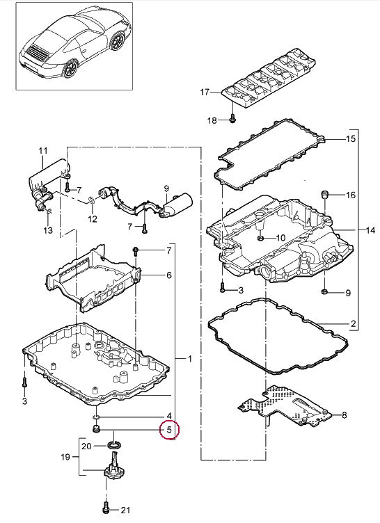

Has anybody done an oil change on a 997.2? I want to know the location of the oil drain plug. Thanks.
Vic
Item 5 is the drain plug.
Be sure to use a new sealing ring - item 4 (900.123.106.30).
