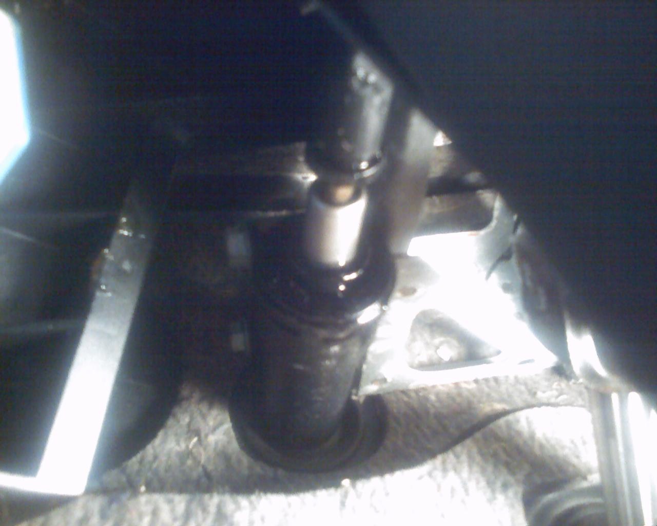

Found leak it is inside cabin "note Pics" by the pushrod that goes into the firewall. I had the brake master cylinder replaced not to long ago but not sure that's where it is coming from? The parts show just one seal between the master and the booster so is this another bad master cylinder or can I purchase a internal master seal? Also need to know what to use to clean the floor mat and carpet underneath "what a mess".

The cylinder in your pic. is the master CLUTCH cylinder, the master BRAKE cylinder is not visible from the inner side of the foot well. You can clean the mess up with water, brake fluid is soluble with water.

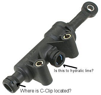

Thanks good catch how is it removed hard to tell by diagram. It looks like there are no hydraulic lines to disconnect and not sure where the "C-Clip: is located to remove the unit is it inside cabin or other?

Disconnect the cylinder push rod from the pedal, disconnect the cylinder from the pedal box, remove the upper flexible (plastic) hydraulic line from the cylinder, push the cylinder backwards and remove the rear flexible hydraulic line (in the front trunk besides the brake booster). You can use the old "C" clips in case of emergency.
