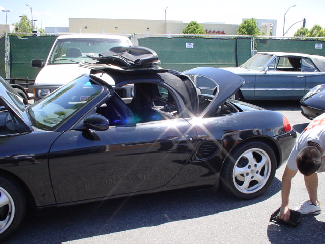

It is not going to be the filter. You need to come to a work on cars day. Every filter we remove has all kinds of crap on the black foam and there is no check engine light related to the filter condition.
We tap it on the ground and all the junks come out. If the place we are using has an air compressor then we blast it with air.
