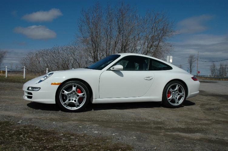

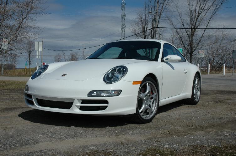

Love the white Porsches! Nice car.
I also had my oil change very near the initial break-in period. I have always done this with all my new cars. I think it is good, and cheap, insurance.
I actually love the electronic dip stick, and think it works great.
Yes the electronic dipstick is very good. But being an old Porsche type, I miss the manual feel of a dipstick!!!!
Yes I've always changed my oil at the end of break-in...As you say, cheap insurance!! So true..
The color was the only thing I didn't have a choice on as the car was already in stock at the dealer. But I got all the options I wanted and as it was a 2008 I had a very good discount. I considered ordering a 2009, but as it was a new model I wasn't sure about any issues with the new cars....So far I couldn't be happier with the car. And as far is white is concerned I really do like it.....In fact, if I do buy another one in the future, it would be white!!
