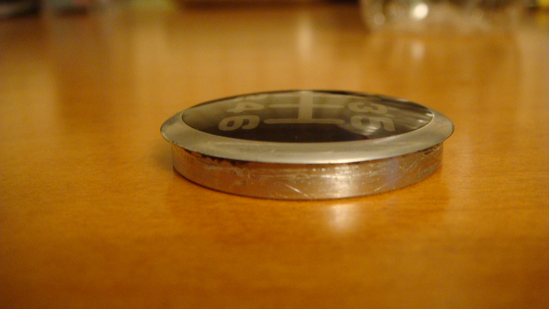

edit to add photos.
ps. looks like it was glued from the side.

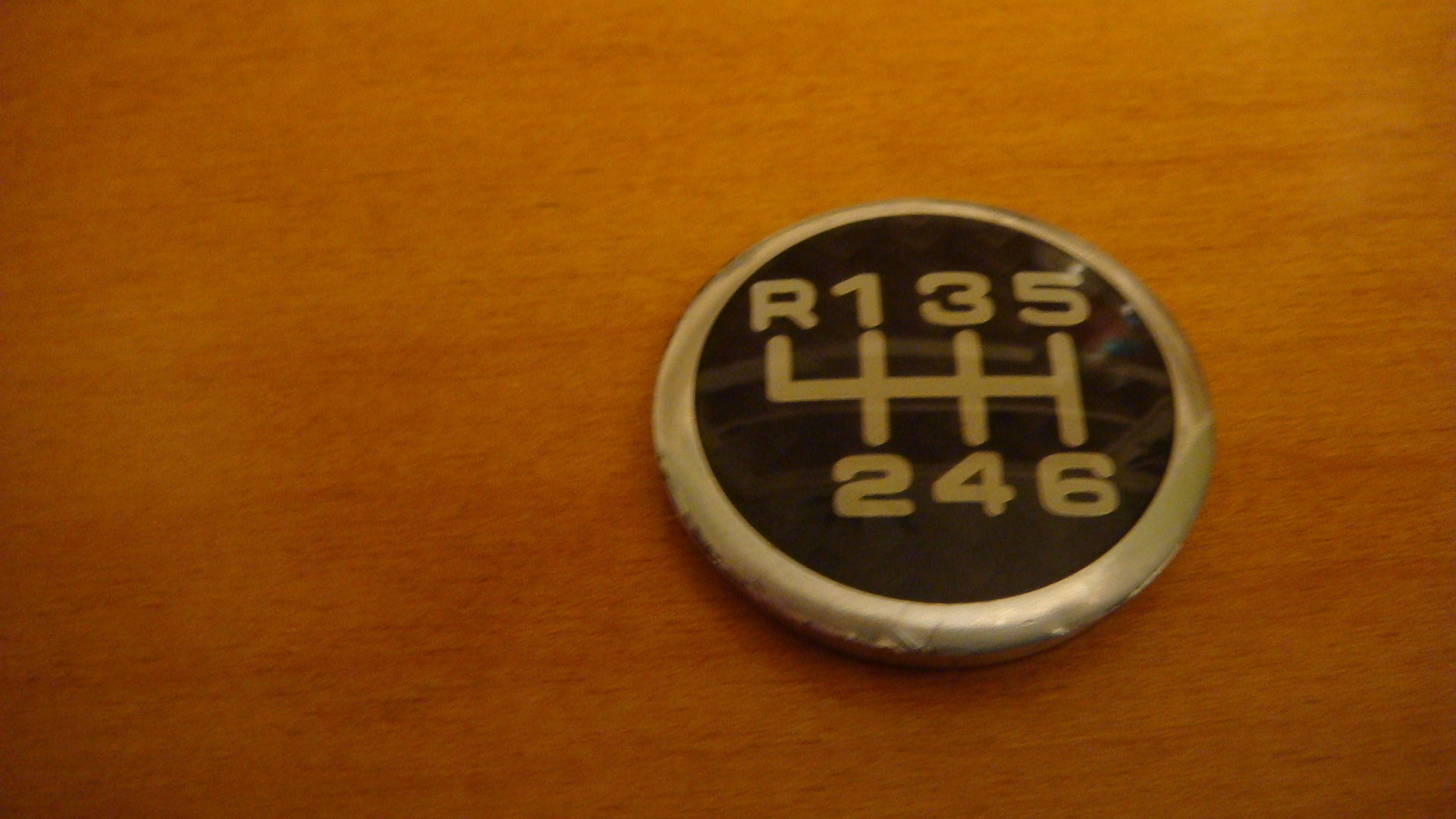

you're welcome. not sure what type of CF shift knob you are looking at but here is a pic of mine. (thanks to member Phillipj)
the above pictures of the 6 speed shift pattern button can be popped out and replaced as I did, but finding a 5 speed CF shift pattern is another challange.
