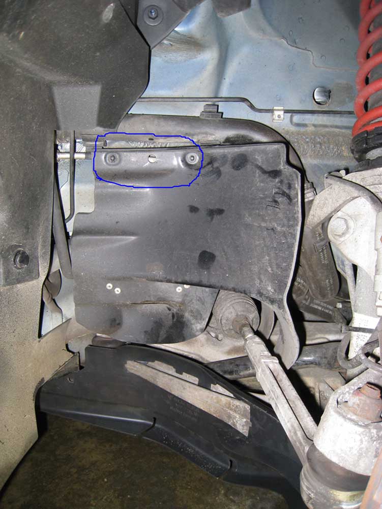

While installing Cargraphic grills a couple of weeks ago, I noted that I had the panel pictured below only on the pax side. Couldn't see any indication that it was missing from the driver's side, e.g., empty attachment holes. Looks like I'm missing this shield on the driver side. I assume it was not replaced when I had the driver side fender replaced (that's another story). Can you give me the p/n of the driver side shield so I can check against the repair order? Thanks

If you look a few post below your I had a similar issue with this plastic shield but my clips were broken . It is not shown on any parts list for the GT3. You should have a plastic shield on both the drivers and passengers side. One must have fallen off or left off. The clip part number is 999.507.785.40. With this maybe the dealer can figure out the part number of the shield. Best of Luck.
Shield (actually, air duct) p/n is 99657523130. It is on the parts list, but the pic doen't look anything like the part. The Master Parts guy at Carlsen Porsche (Redwood City, CA) found it right away once I brought in the pax side equivalent. (Then Jeff at Sunset Porsche corrected the p/n. BTW, pax side p/n is 99657523230.)
The larger clips on the bottom the of the shield look like they're rivited in. Is that the case with yours?
