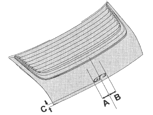

I would like to have the info for placement of both GT3 and Carrera, 996, if possible. I might go for a "911" badge on my Carrera, and would like to put it where they usually stick the "GT3". If I go back to "Carrera" after my re-paint, then I'll be able to tell the paint shop where to place it correctly.

I tried my best with the search function, but could not find the GT3 badge placement. I managed to find the Carrera one, Cayenne, Targa, etc. but could not find the GT3 placement.
1. Find the middle of the lid.
2. Position the GT3 logo with the dimensions A and B = 78.2 mm- and -C = 28 ± 1 mm on the rear lid and affix.

Does anyone please have the dimensions for where to place the GT3 badge on a 997.1 GT3. Thanks in advance
:welcomeani:
GT3 997.1 is pretty much the same as above except that dimension C is 45 mm+/-1 mm.
Center on the lid left to right.
