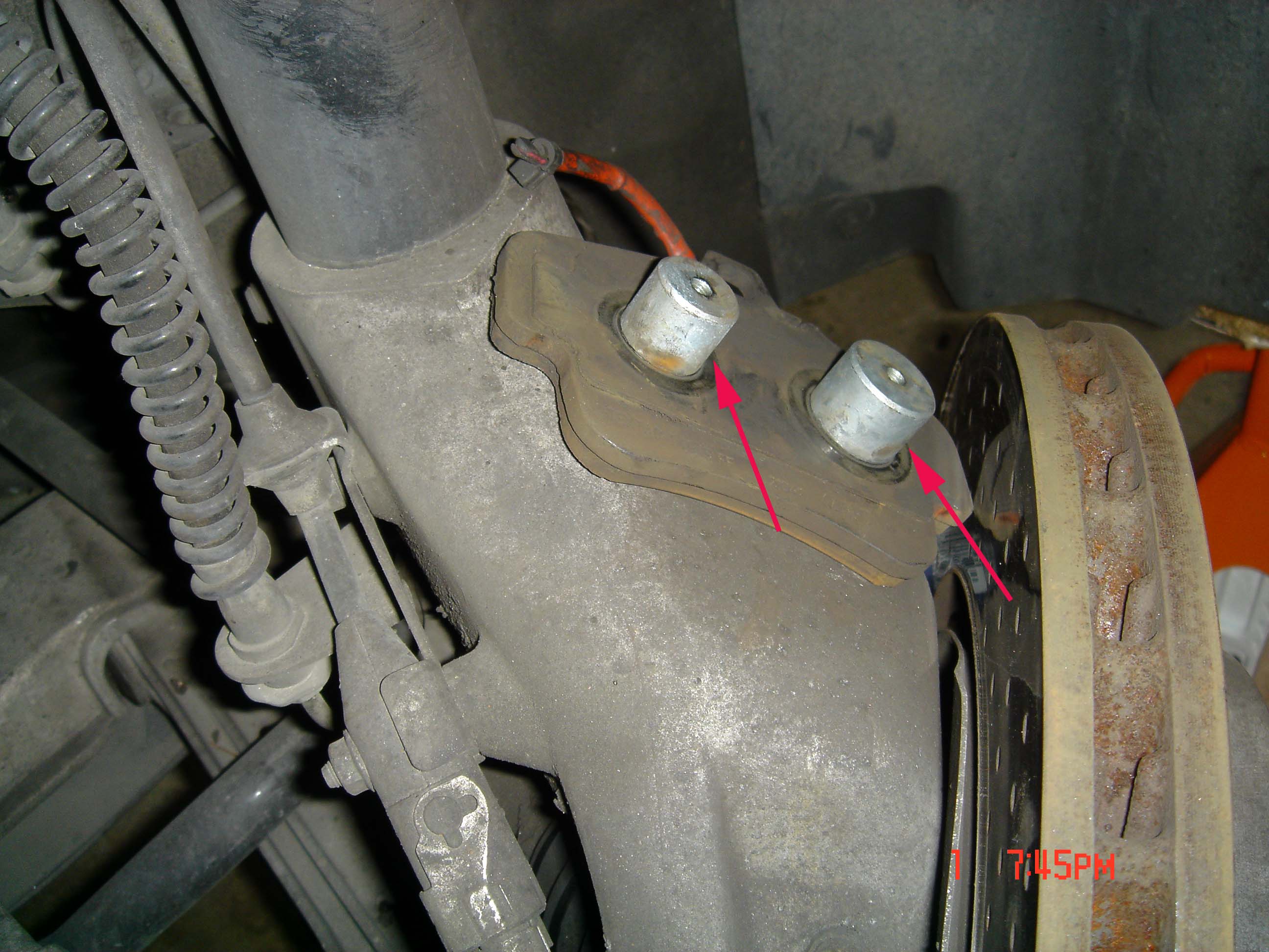

On the first pic, taken of the front pads, are these the pistons from the calipers? Mine were stuck to the pads. Is that normal? Should I reuse them or get new pistons?

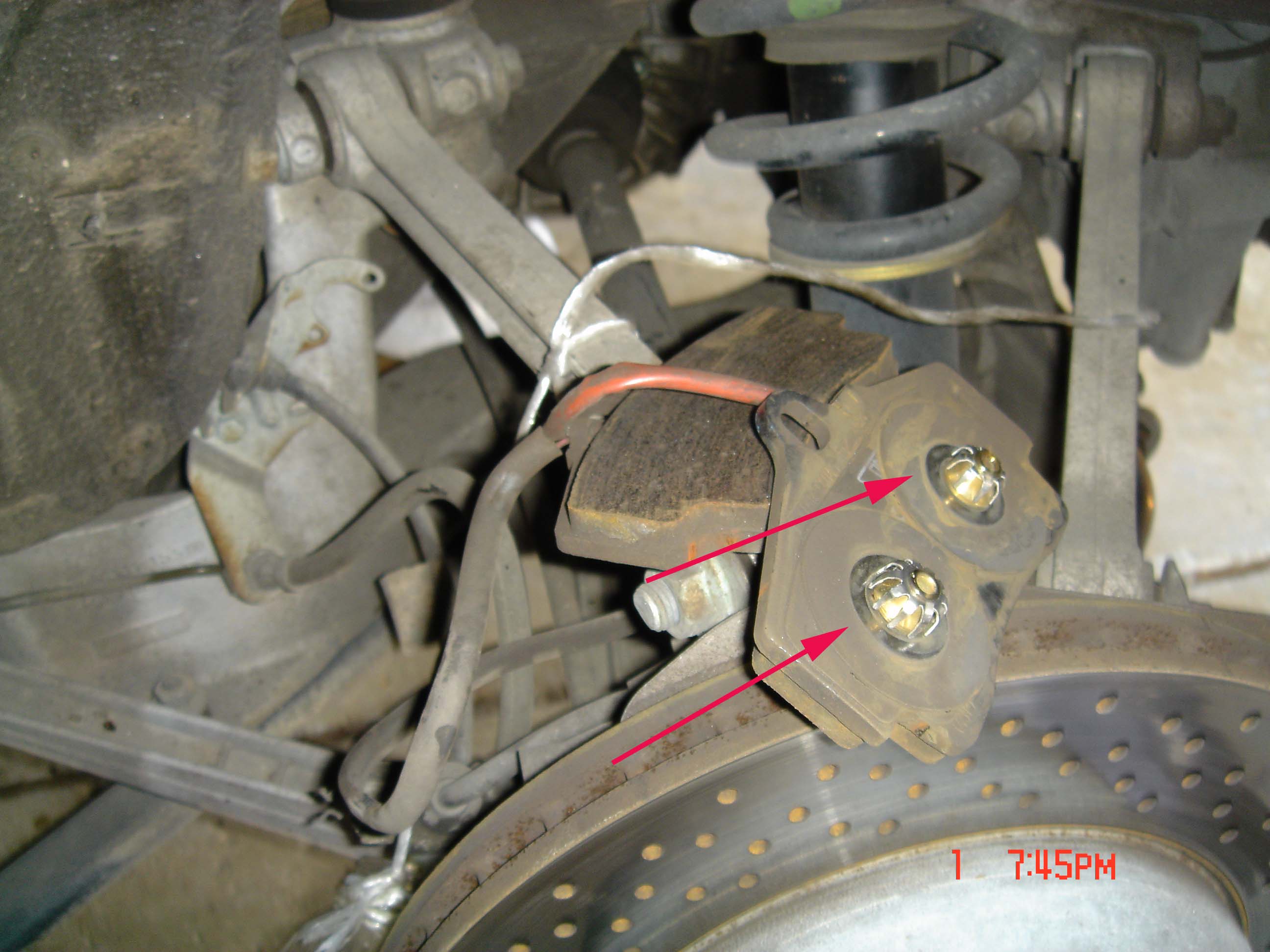

On the second pic, what metal part is the arrow pointing to? Do I need to keep that and reuse or is that a part of the pad that can be thrown away?

Those are the retaining springs that help holds the anti-vibration dampers in place.
Have a look at the brake DIY here for more pics.
