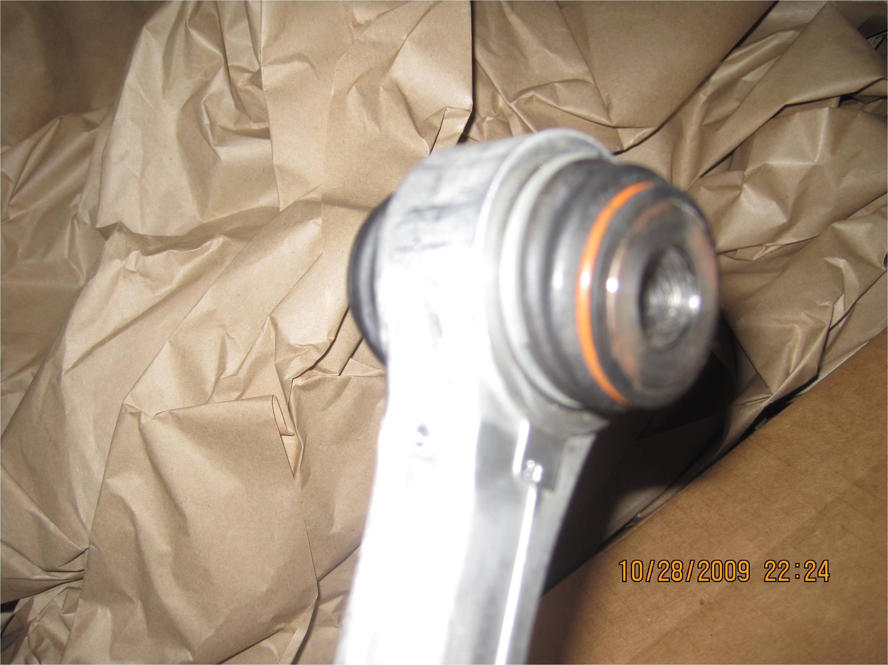

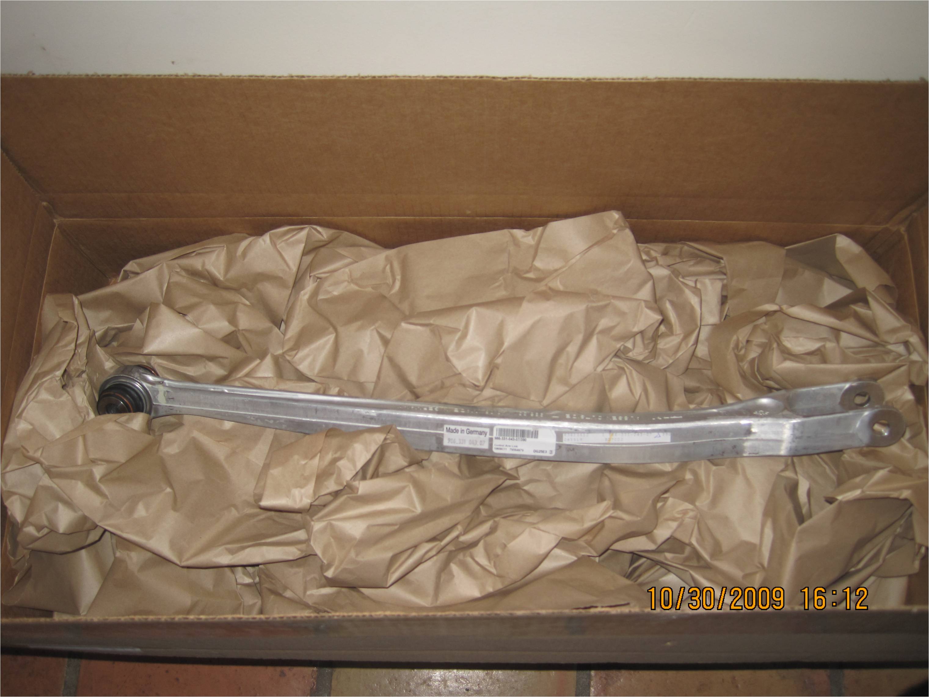

OK, I got the rear track arm yesterday... I doubt ill have time tonight but Im going to try and find the time to do it tomorrow. Once its complete ill post some pics and results...
OK, so its Saturday morning and Ive decided i'm going to get the rear drivers side track arm replaced... or die trying. I printed out a walkthrought that I believe CJ_Boxster posted on here that detailed step-by-step how to replace the arm. It took me all in all about two hours.
I jacked the wheel up, removed the plastic housing in the wheel well, removed the bolt attaching the arm to the wheel assembly then the bolt that attached the arm to the chassis. Both bolts were extremely difficult to loosen, especially the one attaching the arm to the chassis! That one took a LOT of motivation!
I reinstalled the new arm in reverse order. It was a little tough to get the arm back in place. Then it was even more difficult to get the bushing aligned correctly so that the bolt would fit in the hole where the arm attached to the chassis. I managed to get it all lined up and torqued back on. Put the wheel back on and took the vehicle for a spin.
I started the car (which was a little weird, see my other post), let her run for a few minutes than took her around the block and down the street.
The CLUNKING NOISE WAS GONE!!! So this fix did remedy the clunking noise for me!
Problem... SOLVED!
