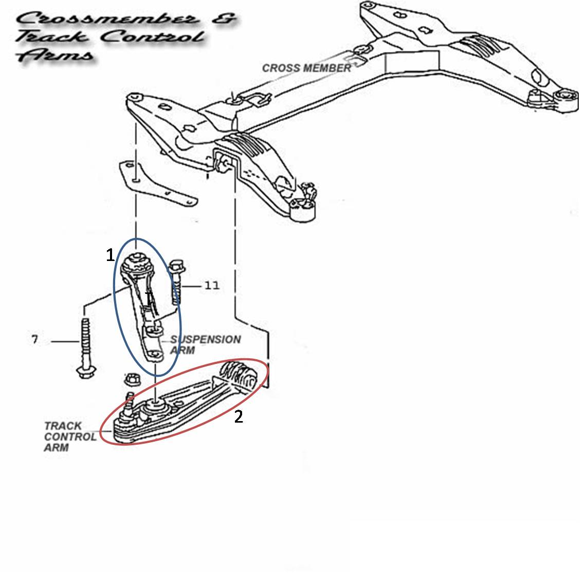

Ive included a graphic to note my issue. The item circled in blue (labeled with a 1) is referenced here as the "suspension arm". I've seen the same piece referenced elsewhere as the rear control arm?
Is it this piece circled in blue that is the likely causing my clunk or is is the piece circles in red (labeled with a 2) that is more likely the problem? My initial thought was that it was piece circled in blue, however looking at the diagram the piece circled in red seems more "mechanically" likely as it moves up and down.

The one circled in red is the lower control arm. It attaches on one end to the suspension subframe and then with the ball joint to the wheel carrier on the other end. In the rear, it adjusts camber via a bolt with a cam shaped face on both ends - as you rotate it, the control arm moves in and out. This adjusting bolt passes through a bushing pressed into the arm.
The one circled in blue is called all sorts of things - track arm and thrust arm seem to be common names. It attaches on one end with a simple bolt through a bushing on the control arm, and the other end attached to the chassis up behind the forward plastic fender liner. You really have to remove the fender liner to see where it attaches and to inspect and determine if it is tightly attached up in there.
The last one on the rear not in the picture is the toe adjusting arm. It attachs to the subframe and to the wheel carrier and uses a similar cam like bolt to adjust toe in and toe out in the rear.
All of these suspension pieces have bushings or spherical bearings that need to be checked; all the nuts and bolts need to checked for tightness. You need to do your best to try and move the assembly up and down to see if you can repeat and isolate the noise.
I would lean to the sway bar like you mention. Even if the bolts are rusty and tight, are the sway bar bushings still in good shape? You should be able to see the edges of them squeezing out of the U shaped pice that attaches to the frame. Are the drop links tight and not hitting the control arm when moving up and down?
And don't forget to check the strut mounts at the top of the coil overs - they to can wear out and allow movement up top.
Hope that helps.
BTW - the image is of the front suspension. The subframe in the rear is quite different.

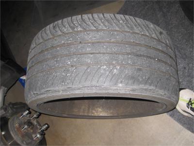

You mentioned tire wear... I did have extremely bad tire wear. The insides of the tires where worn to the wire, the outsides still looked new! It was almost impossible to see the wear without taking the wheel/tire off the car! The tires dont have many miles on them, a little over 20K and I never drive the car hard. My initial thought was the previous owner just had them set aggressively...
Is there possibly a loose/broken part that would cause this kind of wear?

Without seeing the tire, it is hard to know what is causing the wear, but assuming the car tracks straight, I would guess excessive negative camber. If the car crabs, then I would think toe out.
Unfortunately, I don't think it narrows down the problem for us, because a problem with any of the arms or even the strut mount could give you funky camber or toe, giving you ugly wear.
Most alignment shops will to set rear camber the same on both sides unless the customer wants different, so take a look at the other tire and see if it has the same wear. If so, and the car tracks straight, then you porbably have too much neg camber. But it doesn't explain the noise.

That tire wear looks like a rub to me, not something that would happen from being out of alignment - or could be, but the camber would be ridiculous and hard to miss.
Not sure what coilovers you have or where the ride height was set. But check clearance on the spring perches, springs, coilovers under there. Maybe he had a problem and fixed it but left the tires, but it deserves a look when you get it back on the ground.
Bad bushings are usually dried out and cracked. You can tell by looking at them. Sometimes they are even split.
Try to lift the assembly straight up and down to see if the coilover moves in the upper strut mount. While I wouldn't take this to the bank, a bad strut mount - which likely means the bushing in the mount is shot or it is no longer mounted tightly - would make noise and could provide slight alignment issues.

My money is on the rear control arm that attaches to the body behind the driver and passenger seat. I had the same clunking noise when traveling at low speed up to 30 MPH from the rear, sounding like something was loose in the trunk. Replaced both control arms and the noise is gone. Not a cheap item about $ 628.00 for both of them. You wont be able to feel any play in the bushing but it is sill bad. BTW my car had only 40K miles on it. Hope this helps.

Can you ID the part that you replaced, ive heard "control arm" used interchangeably with a few different parts of the rear suspension... In the attached picture is it the one circled in blue (labeled 1) or the one circled in red (labeled 2)??
I think you are referring to the blue circled part, thats actually the piece that I originally thought was the culprit.
It seems like its a fairly straightforward part to replace, did you change this out yourself or have the dealership do it?

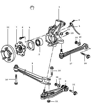

Picture you have is of the front suspension. Here is the rear.
I believe Boxsterfahrer is referring to number 8. It is the one where you have to remove the plastic fender cover to see where it attaches. Tight squeeze up in there.
ericinboca,
Thats the item I originally thought was the trouble maker. Like you mentioned ill look a little closer into the swaybar and double check all the bushings for cracks/splits. If none of that works then thats the first part ill replace!

Yes, it is item #8 and I can almost guaranty that replacing these will get rid of your noise. I fixed mine temporarily by peening the bushing ( described in a previous thread ) but it lasted for only 6 month and then reared it's ugly head again.
