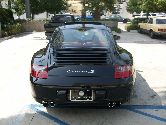

If you have the PSE your exhaust tips will be different sizes. Attached is a pic of my car with the PSE. You can clearly see that the outside tip is larger than the inside tip.

Do you have the exhaust tips that are different size? If so then you have the PSE. Like I mentioned the 05 and later 997's with PSE did not come with a switch (like the 996.) Mine is activated when I put it in "Sport Mode" (I have the Sport Chrono option.) In regular mode I get no PSE <_<

No I only have the normal Carrera oval tips. I did know that PSE has the two round tips with one smaller than the other, but I didn't know if you could install PSE mufflers without installing the entire system. It looks like I just have a stock Carrera exhaust system. I'm thinking about getting the PSE system, but I see that the price went way up a couple of months back, and so my negotiations with the wife will be a bit more difficult :rolleyes: .
