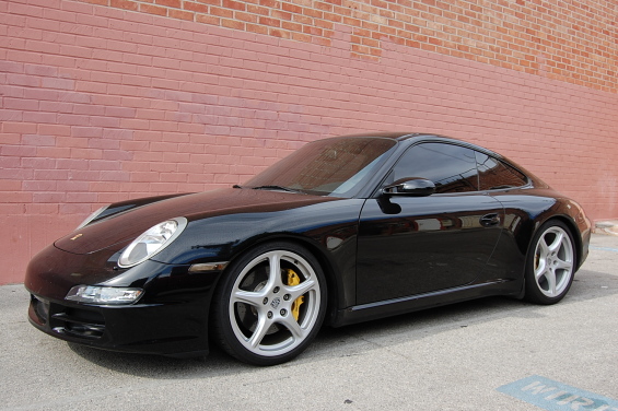

Does anyone know what the 2005 to 2008 stock 5 spoke 19 inch Carrera wheel weighs? I have been investigating replacing my wheels. I want to be able to compare wheel weight. Can't find the information anywhere.
Pic shows wheels in question.
Thanks!

Don't have P/N's but here is what I can find. Hope it helps. B)
Porsche 997 Wheels
Porsche Factory Carrera S
8x19" 22 lbs. 4 oz.
11x19" 27 lbs. 12 oz.
Porsche Factory Carrera Classic
8x19" 23 lbs. 10 oz.
11x19" 28 lbs. 11 oz.
Porsche Factory Carrera Sport Design
8x19" 24 lbs. 3 oz.
11x19" 28 lbs. 3 oz.
8.5x19" 24 lbs. 2 oz.
11.5x19" 29 lbs. 4 oz.
Forged Turbo Wheels
8.5x19" 23 lbs. 8 oz
11x19" 27 lbs. 14 oz.
Porsche 997 GT3
8.5x19" 24 lbs. 5 oz.
12x19" 30 lbs. 13 oz.
8x19 (987, 997 non turbo front) 23.4 pounds
8.5x19 (997 turbo front) 23.9 pounds
9.5x19 (987 rear) 25 pounds
11x19 (997 turbo rear) 28.8 pounds
Carrera III Wheel Weights
8x18, 22.0 lbs
10x18, 24.9 lbs
