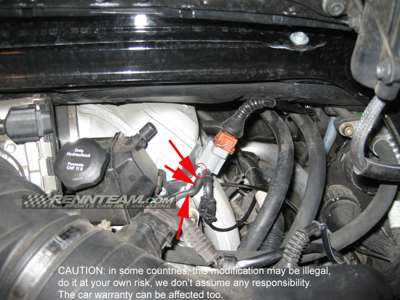

But i don't really get it. Do i have to disconnect the brown connecter or one (of the two) black ones wich alse lead to the grey box?
I also tried to disconnect eithet one or them but this also is working for me.
Can anyone please discribe to me step-by-step about what to Do? I really want the noise all the time quick !!

I made up a kit to allow you to turn on and off the PSE at will and prevent the 20 -40 mph cut out. Personally I think its a more elegant solution to unplugging the unit and allows the control to be returned to normal come service or when you feel the 70 mph drone is becoming too much. The pug has a metal wire clip that needs to be squeezed to allow it to release from the grey solenoid.
I turned mine on all the time.. Here is the way I did it. Just unplug the brownish/orange connector in the picture. Or you can take off the hose with the red pointer. It's easier to just disconect the plug. I tie wrapped it to an AC hose so it would be secured and made little "condoms" out of the fingers of latex gloves so debris wont get into the connectors.
You can try it this way and if you don't like it on all the time you can always plug it back in.

That looks a tidy install , but a bit pricey. Rather than run the risk of losing a key fob , the other option is to simply fit a switch as myself and others have done. I made up a simple loom and plugged into the existing plugs so there was no cutting of wires.
