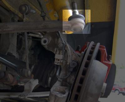

Can the seal be replaced or does the whole toe arm need to be replaced?
(seal cannot be replaced-entire rear control arm needs to be replaced if ball joint worn or rubber seal torn)
Borrowed picture attached showing toe arm seal highlighted.
2001 boxster S (Left REAR Toe Arm)
