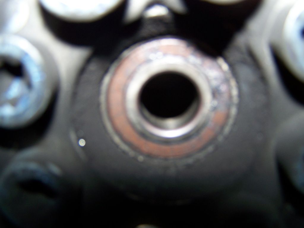

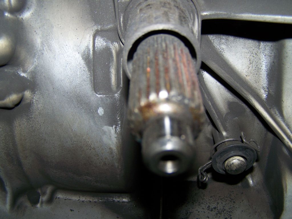

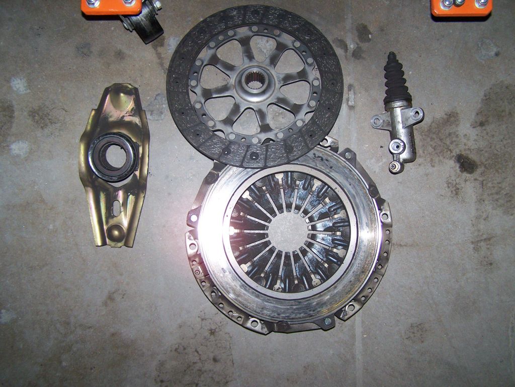

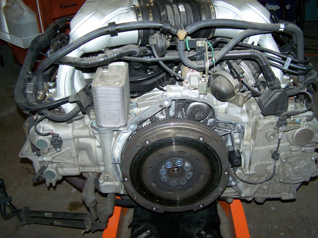

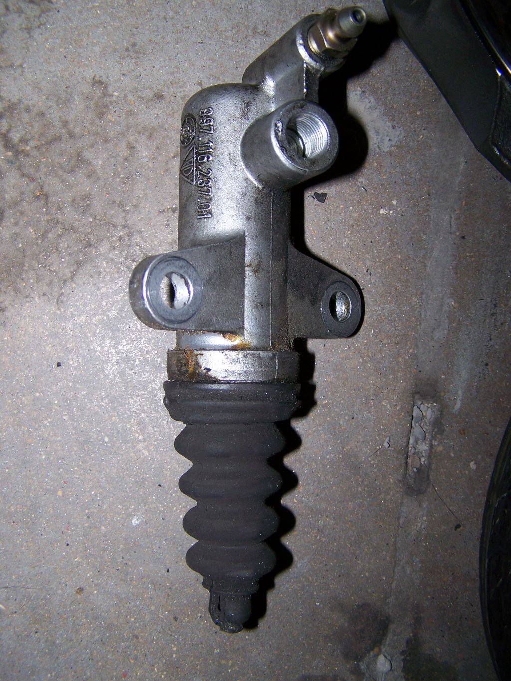

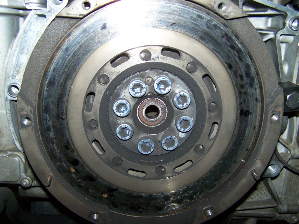

Okay! Time for Update! Mechanic removed the engine and transmission and took the clutch apart. We didn't really see anything broken. Burnt spots, some rust, pilot bearing not moving freely, oil leak behind the flywheel seal. Slave Cylinder was replaced before taking down the engine/transmission because it wasn't engaging properly but that didn't fix the issue. So the total is going to cost me $1560.
Labor: = 782 (9.2hrs x 85/hr)
Slave Cylinder = 92
Brake Fluid = 7
Clutch Kit = 600
Flywheel Seal = 18
Pilot Bearing = 35
Power Steering Fluid = 11
Coolant = 15
See pictures!!!!!!
