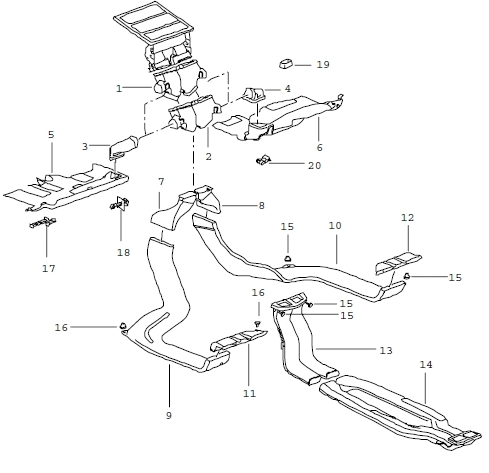

Well that is sort of good news - a start anyway. Can you temporarily move the NAV-tv unit to the glove compartment to see if this eliminates the problem? The other thing i'd check is that all the ducts are not compromised - collapsed or inadvertently pulled apart / punctured during installation. Image shows the duct layout for a 9PA Cayenne; should be pretty close to yours. If you don't see anything readily apparent, remove the PCM and turn the blowers / fans on high, then feel for leaks. If you tape / tie a piece of tinsel on a wooden dowel it should flag a leak location when used as a probe.
