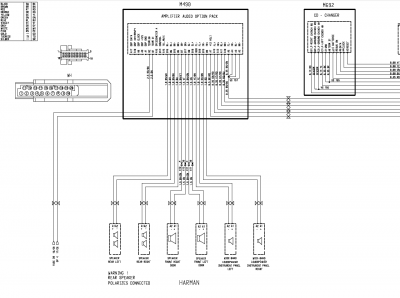

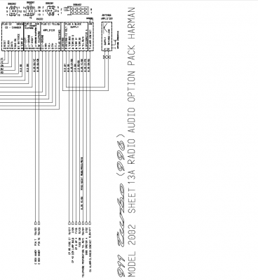

From various schematics and other post here is what I am seeing on the input connector to the amp.

That is pretty close to what I have on the 99-00 schematics. The DSP DATA wire is missing though.

I should have said I have the turbo schematics but they are from 99-00 not 01 but from what I see they should look the same.

Regardless the schematics that I have appear to be representative of what I am seeing in my vehicle.
I am still looking to see if anyone is using this amp with an aftermarket unit and if so how was it connected. At this point I am not sure it is possible.
Thanks for the schematics. They are basically the same as I have but they are laid out a little better. I am getting to where I don't even need schematics any longer. I have them memorized. sad.gif
I do not believe that I have the DSP option. I did some searching and this seems to be a EQ type device. There isn't room with the factory navigation. The input connector on the amp does have wires in pins 1 (DSP ground) and 17 (DSP data) but not 8 (DSP clock), 9 (DSP power) or 18 (DSP interrupt). The two which are there appear to go to plug II according to documentation which I found in another thread (I think posted by you). This seems to checkout based on my measurements.
Plug II
6 - DSP (amplifier) ground
14 - DSP (amplifier)
At this point I don't know if this is the cause of my problems or not. It is simply the only signal that I can see that is different at the amplifier from the old unit to the new unit.
