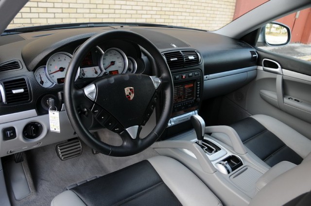

My wife and I are currently in Iraq, deployed contractors in the IT field. We have recently put a deposit down on a 2006 Cayenne S Titanium Edition. The dealer is going to hold the vehicle for us until we return, which is the end of this month. This will be a first for both of us as far as a luxury vehicle and it being a Porsche! A few pics of our Cayenne...
