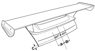

Can anyone help with the placement of 996 GT3RS decklid logo. I thought I saw it here once but cannot find using search.
Thanks
Steve

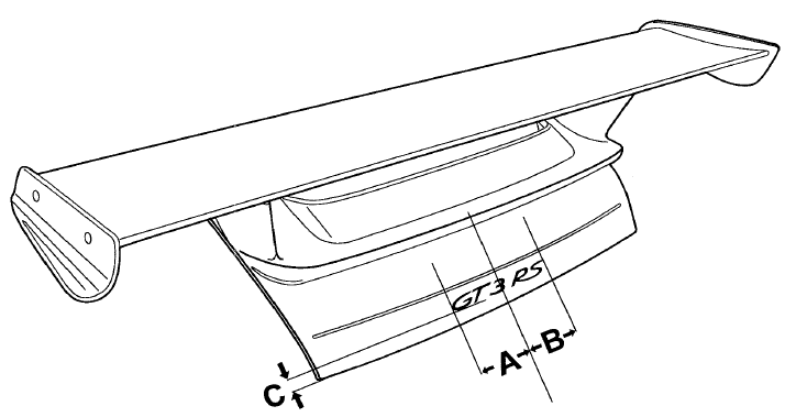

1. Find the middle of the lid.
2. Position the GT3 RS logo with the dimensions A and B = 191.2 ± 1 mm and C = 28 ± 1 mm on the rear lid and affix.
