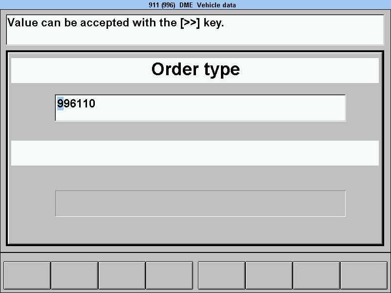

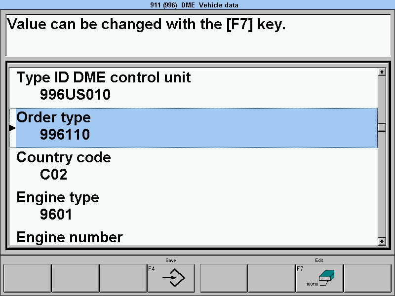

Check your DME to see if the orderl type is set. Many 2003 and 2004 cars came from the factory without this set - and you can not program or change the programs without it being properly set.
This is for a 996 - but you get the idea.

If the order type is set then you should be able to change it.
I have done this on a dozen or so cars.

I would have to do it again to remember the exact sequence but here is what I recall.
Make sure the order type is set in the DME. If it is not then set it - exit PST2 - turn the car off. Reconnect.
Set the OBC on in the cluster (2 places - I can't recall - perhaps one in the DME too).
