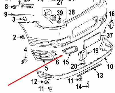

HI,
Was wondering if anyone knows or has a diagram/instructions of how the exhaust ducts are clipped in / removed? It is #15 in the image with the red arrow pointing to it.
I was hoping to NOT have to remove the bumper cover, but suspect it may be required. Before I started trying to figure it out and potentially damaging something, I thought I would ask here.
Any help, instructions, images, etc.... Appreciated!

Well..
No one ever responded....So I thought I would share, that the Rear Bumper cover has to be removed to get these out. Once the Bumper Cover is off, they simply have some plastic tabs that allow you to snap them out from what would be the inside of the cover (when it is on the car).
Maybe that will help someone else who may need to remove them.
