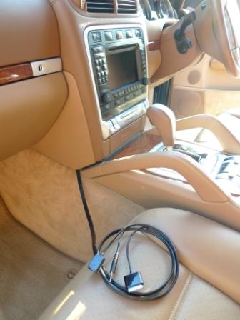

The installation is mostly hidden behind the PCM. I have the microphone clipped to the small sunvisor above the rearview mirror, with the wire hidden away behind the trim at the top of the windscreen and down the A-pillar. The lead for connecting Ipod/USB/Line in emerges from the centre console, but you could easily have it in the glovebox if you wanted. The small remote controller is wireless (powered by a button battery) and can be positioned anywhere, including on the steering wheel - I have mine on the roof console.
post-44248-004874100 1277750360_thumb.jp
post-44248-010100200 1277750372_thumb.jp

I had to move the steering wheel to make space for the installation! wink.gif
The main box simply connects between the factory stereo and the speakers using standard ISO connectors. It contains its own amplifier for the music signal. The sound quality is excellent. You switch between the factory stereo and the music signal by pressing a button on the remote controller, which can also control volume/play/pause/skip forwards and backwards. Either source is muted by phone calls, which are heard through all the speakers. Again, call quality is excellent.
