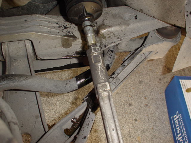

I have a leak from the seals in my power steering rack with my January 1997. Easy to tell. There is nothing on the ground. The fluid fills up the boot. Remove the small clamp and it runs out of the boot.
