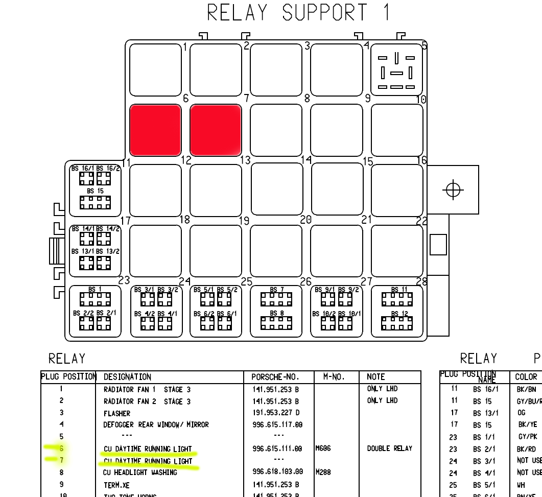

I remember there is a hack for the headlights. Look at your fuse box and see if there is a jumper between the fuse A6 and A9. If there is just remove it....DRL hack and if there is not jumper and you do have the daytime running lights it is because you have the DRL relays installed. It was require when I did the importation of my TT to Canada and Porsche was asking over $400.00 to install these relays..... If you look at the relay support number one ( just over the fuse box) and found two relays in position 6 and 7 part number 996 615 111 00 you have DRL installed on your car .... Sorry just realized you have an my01 but look for those relays in any location on the support relay....
post-29683-085486100 1286119257_thumb.pn
post-29683-001268300 1286131529_thumb.pn
