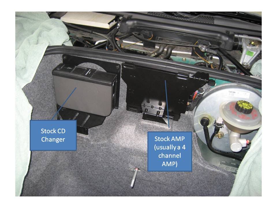

I'm not sure if I have an OEM amp. I'm not good with electronics. If I do have the amp where would they be so I can check?
Both the AMP and the Stock CD Changer are in the front trunk behind and above the spare tire.
I definitely don't have the cd changer. But I will look into the amp.
So if I do have the amp, all I have to do is unplug everything from stock and run it into the aftermarket amp also RCA to the back of the factory radio right?
Thanks for the picture!
