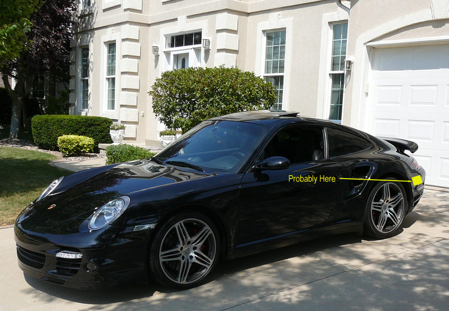

The rear sensor on my 997 Turbo is located inside the rear bumper cover. Have to remove the rear cover to get to it. Usually on the side pieces so it can point back...Likely the driver's side.

Where would that be in relation to the driver's side tail light? Do you what it is mounted to in there?
It can really be anywhere,but as indicated in my picture I attached, is likely mounted (glued/ body putty/ Velcro) to the inside of the actual bumper cover (where I indicated). It will be below the tail lights and actually in the cover itself. If you look where the yellow box is in my photo, it will likely be on the inside of the cover, or mounted on the chassis right there or nearby. That is one location where there is room for the box to fit. If it is not the blue-tooth version, you can likely follow the wiring?
Either way...I think if you remove your rear bumper cover you will find it pretty easily. Won't be near any of the exhaust components to prevent damage.
Hope that helps.
Hope that helps.
