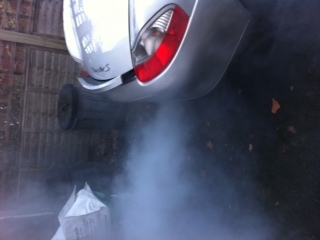

P.S Also - pls see attached photo of smoke on turnover.

You car has been sitting and that leads to smoke. But not the second time you use the car afterwards.
Your AOS has been bad, that leads to smoke, dirty intake, dirty throttle body, fouled plugs, contaminated cats, oil covered O2 sensors, etc. That is if you are lucky and didn't experience hydrolock.
Have you looked at your anti-freeze expansion tank and its contents.
That chocolate milk you describe reeks of intermix of oil and water.
By hydro lock, the start motor can get the engine up to around 360° before the engine gets stuck by infiltrated liquid (depending the specific piston possition) Hydro lock can damage engine components as cracked liners, bent rods (when driving through deep puddles of water, a quantity can enter in to the engine via air filter) etc. Will occur occasionally during the RAC rally in the UK. This is a general description of a hydro lock. I hope it brings some clarity on the issue lock.
