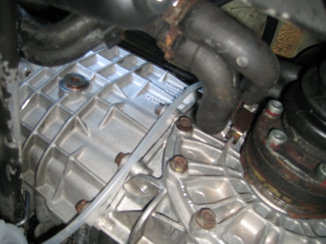

1) Use the car jacks to bring the car up as hight as possible. Search for the the bleeder valve. It is well hidden: Follow the driver side rear wheel to the gear box and look high up. You see two hoses, above one is the valve.

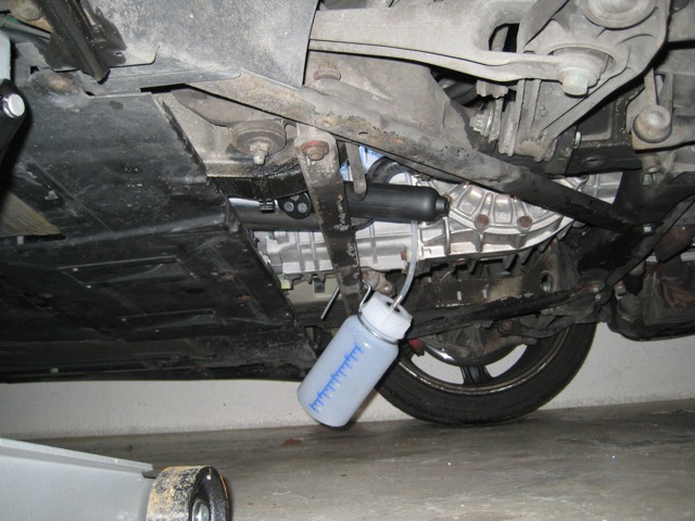

2) Now comes the difficult part if you have large arms and hands: Reach to the valve and take off the valve cap. Attach the wrench with the closed round side to the valve so that the other end of the wrench touches the underside of the car. This makes it easy to open (pull down) and close it (push up) again.
3) Attach the hose of the catch tank to the bleeder valve

6) Open the bleeder valve (a few cm are enough) you'll see the green fluid coming out
7) slowly pull and push the clutch pedal 5 iterations
