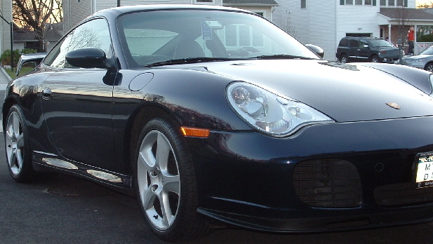

I ordered a set of pirelli 240 snow sport tires from tire rack.225 front and 265 rear. Can those 265's be put on the stock rims 18x11, they recommend 18x10-10.5. Really don't want to buy another set of rims. :drive: If I did buy rims they would be 18x11 dual purpose(snow/track). I acn't have three sets of rims/tires in the garage, wife would kill me.
