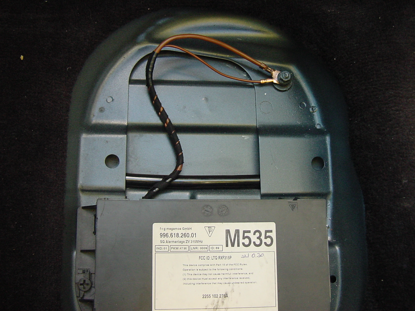

The immobilizer is under the driver's seat. The driver's seat is fastened to the floorpan on two rails. Each rail has two fasteners, one in front of the seat, one under the rear of the seat. The bolts require a female torx socket, but in a pinch you can use a good quality 1/4 inch drive 10mm socket.
Once you have the four bolts out (slide the seat completely forward and get the two rear bolts, and slide the seat completely back and get the two front bolts), there is a large electrical connector under the seat. If you disconnect that connector, make sure that the key is off and out of the ignition switch. Do not turn on the ignition or put the key in there while the connector is disconnected or you will set off the airbag light, which can then only be reset with a Durametric, PST2 or PIWIS tester.
If you want to avoid all of that, the wire under the seat is long enough to allow you to set the seat down exactly alongside the driver's door sill, perhaps resting on a square box or small platform.
Check to see if there is moisture in or near the immobilizer, If there is, you may get away with taking it apart and drying it with a hair dryer and/or cleaning it with isopropyl alcohol to get rid of, or prevent, surface corrosion on the circuit board.
If the car is inside, we can figure out what caused the water to seep into the cabin. Probably clogged drains if the foam drain trays are intact.
Here is a photo of the immobilizer under the seat. It comes off with a slight turn of that one plastic Philips head screw near the lower left corner of the photo.
