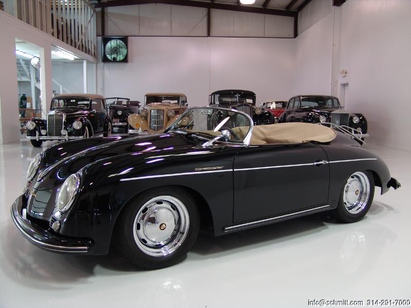

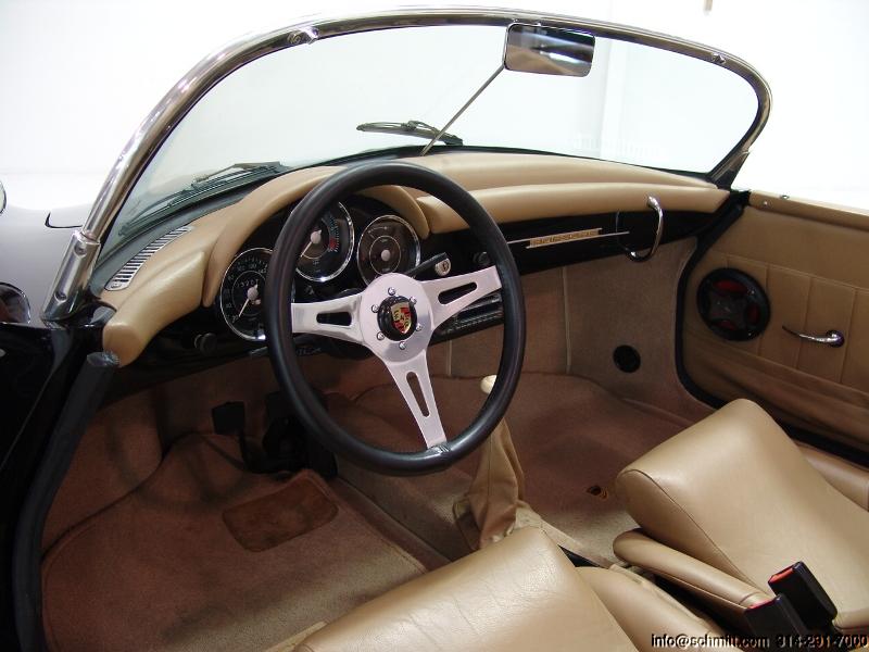

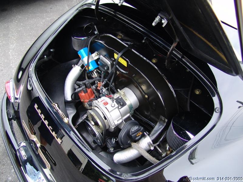

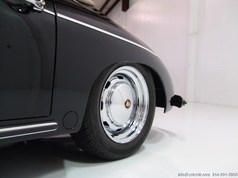

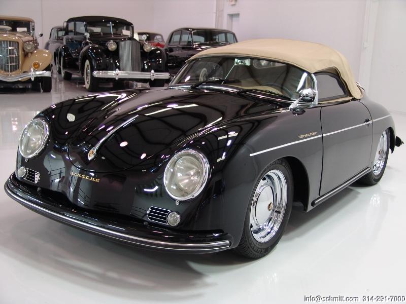

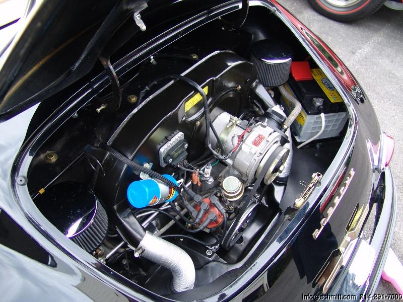

It is a Beck speedster so custom built chassis. It has the Super 1600 VW motor in it. and VW drive train. Everything else on the car is made by beck.
Here are some more pics.
That Speedster is sweet..:clapping: Can you tell us more about it? Power train ect?
