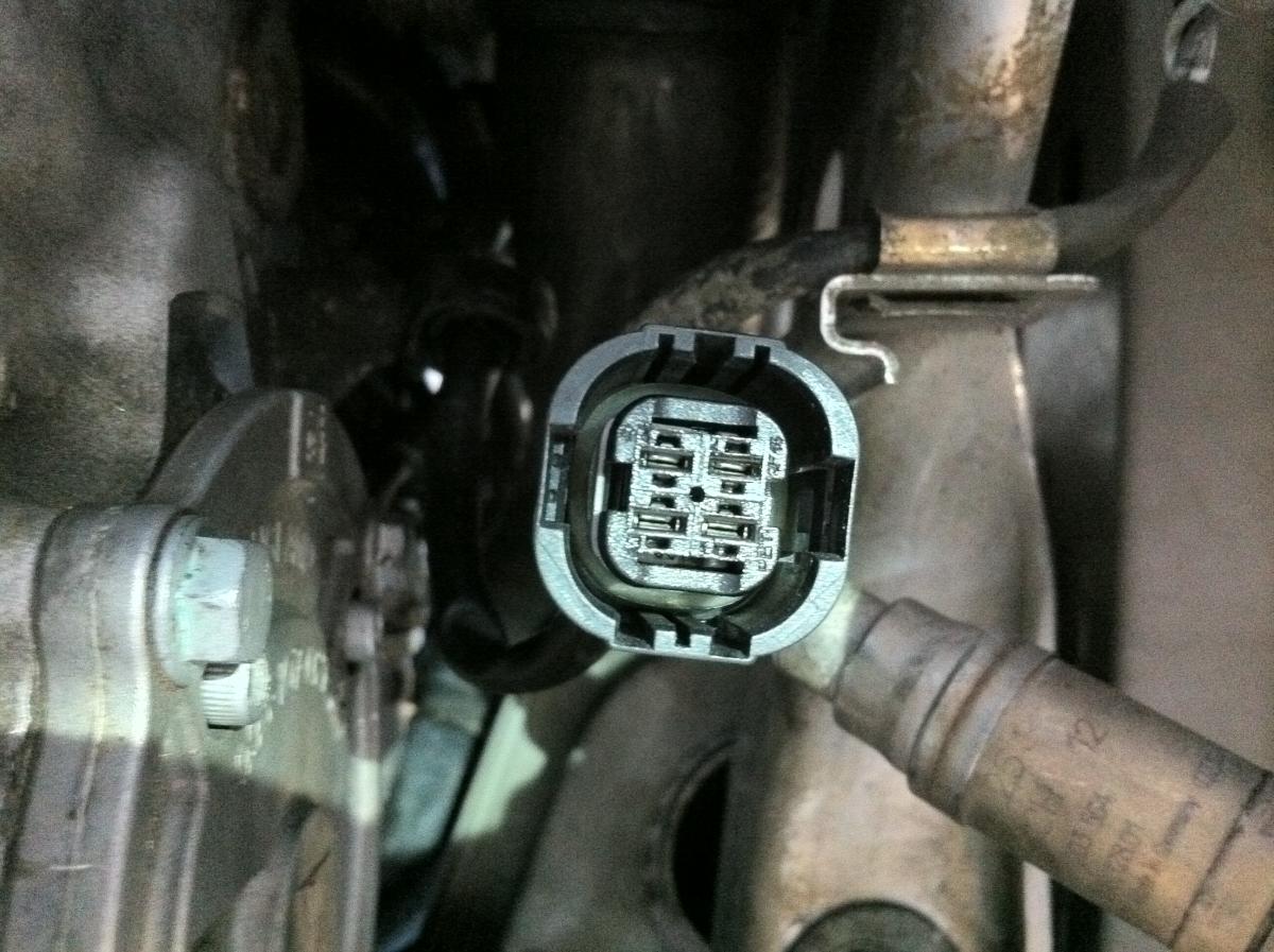

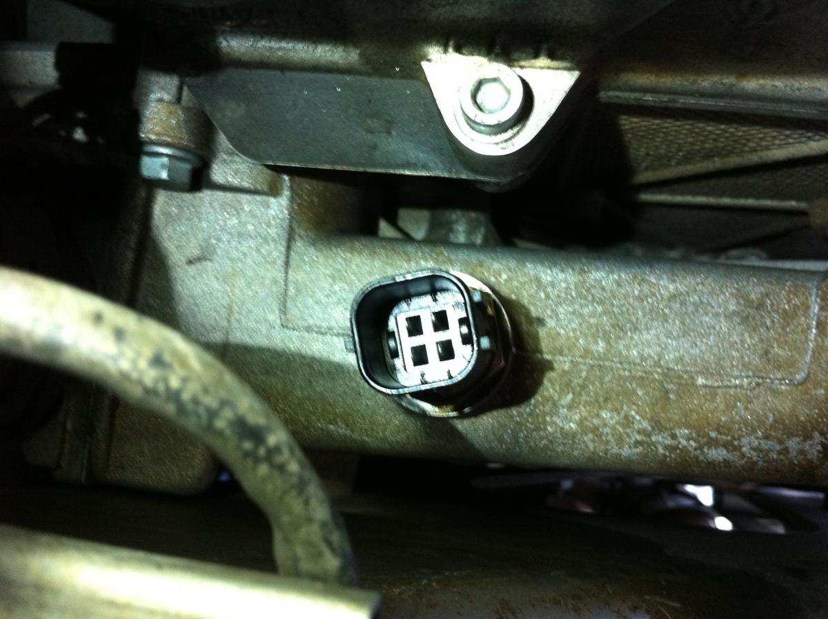

Since I've talked to someone else who had the same problems maybe there are others with an easy fix. Here are photos of the engine temp. sensor and the female connector. I took it apart and now it won't go back together. It goes far enough to make connection but not far enough to latch. The blades look straight and if they make connection they must be aligned. Who's had this problem ? If it looked damaged I would try and source another but it looks O.K. Sorry about the photos.post-55687-0-24176600-1317085481_thumb.jpost-55687-0-61781800-1317085518_thumb.j Is it the connector on the wire or sensor? any Ideas appreciated.
A point for Mr. Vicary. I took a little jeweler's screwdriver and gently poked around at the weather seal and another little springy thing (for lack of words) that sticks out on one side right before the weather seal. Pushed her back together and it latched. Thanks again to Wayne.
