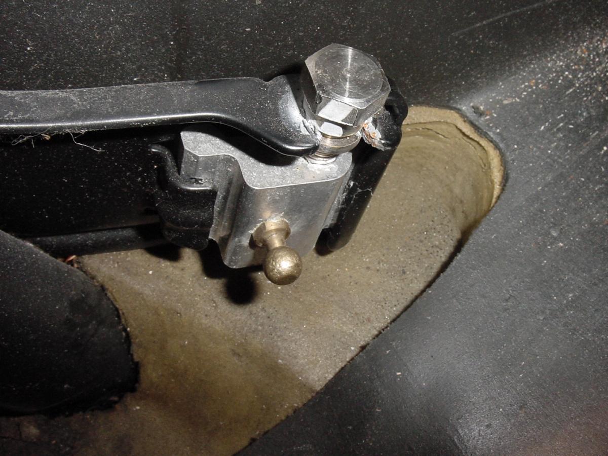

Here are two photos of where each of the two 14mm bolts are located, one to the left and rear of the engine compartment cover and the other to the right and rear. Each of the two bolts are down below the surface level of the engine compartment cover by about 6 or 8 inches:
post-6627-0-34966000-1320278244_thumb.jp
The red arrow points to the 14mm adjusting bolt, and the yellow arrow points to the lower steel ball cup of the cable, here pressed onto (and hiding) the steel ball.
post-6627-0-46133200-1320278279_thumb.jp
This is a look at the mechanism, with the foam drain tray material pulled away from it, and showing the steel ball exposed.
As the 14mm bolt is turned CCW, the steel ball goes down and thus increases tension on the top.
