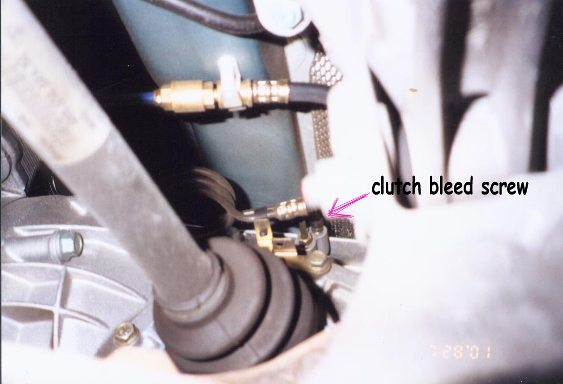

I found out that some of the maintenance outside the regular schedules was not done like flushing the brakes for example. I did it this weekend after I bought a Power Bleeder but could not flush the clutch. Stupidily I could not locate the bleeding valve even though I read Loren DIY !!!! If somebody has a picture that would be greatly appreciated.

I do the clutch bleed after the left rear brake is done because the wheel is off. Hard to see so you do it by feel. Some cars have a 9 mm bleed nipple and some have a 11 mm. Stop by at the next work on cars and we will show you how to do it.

Thank you for the picture it is greatly appreciated !!!
I did not have a jack stand so I was not confortable to do a thorough search.
Next time I will even had the beer bottle for extra safety as you suggested :clapping: . I will try again in a few weeks by just topping the liquid off.
